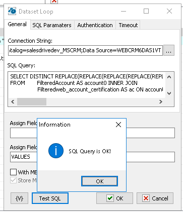

I'm struggling with exporting stuff from SQL. I'm really a n00b with this. My query seems OK according to Robotask, but I have no clue how to export my results (around 1181 lines).
However, "Rows effected" are 0.
SELECT DISTINCT REPLACE(REPLACE(REPLACE(REPLACE(REPLACE(REPLACE(REPLACE(REPLACE(account0.telephone1, ' ', ''),'-',''),'(',''),')',''),'/',''),'\',''),'+490','+49'),'+49+49','+49') AS phone
FROM        FilteredAccount AS account0 WHERE     (account0.telephone1 IS NOT NULL)
Can you make just a simple task which exports the results to a file? Thanks!

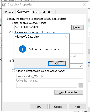

Of course you have to specify your own connection string in the step #2 (dataset loop)

Thanks for your quick answer. The file is being created but without any results. I think that issue has to do with permissions on the SQL server itself.
Again, thanks!

I'd really like to, but there is nothing to tell. My next approach is to enter user credentials from someone who has admin rights in Robotask and see if the result is the same.
Other approach is to login with the Robotask account to the SQL machine and execute the same query there.

I see in the log that the query returns nothing.
The loop ends immediately. The step #3 is not performed at all.
Re: SQL query -> export results
...to enter user credentials from someone who has admin rights...
I don't think that this helps you.
You will get error when you have not enough permissions to do SELECT query on this table/view.
But I see that query performed successfully. No rows means that the condition is incorrect.
