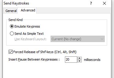

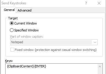

Hi Oleg,
It's not working for me.
1. I need to type clipboard content and don't know if it contains special chars.
2. I use free version and regex module isn't available.

Hi Oleg,
Unfortunately, it's not working for me.
1. I need to type content of clipboard and I can't know if it contains special chars or not.
2. I use Lite version without RegEx module.

you can use system powershell to make necessary replacements
for example, use such command line:
powershell -Command "(get-clipboard) -replace '([\^|\%|\+|\#|\{|\}|\(|\)])', '{$1}' | Out-File -encoding ASCII myFile.txt"
You can use regular expressions in this command-line
You will get the file myFile.txt with necessary replacements as a result.
If system Clipboard doesn't contain some reserved symbols the command will return text without changes.

Working.
Спасибо Олег.
