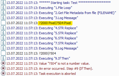

I want to get height and width from metadata of an image file with action 'Get file Metdata' to compare it and eventually rotate the image.
The data is always extracted with a preceding '?'.
I have tried unsuccessfully to delete the sign. I tried 'STR Trim' and 'STR Replace' but it is still available in the data.
Screenshot 2022-07-13 114225.png (37.92 KiB) Viewed 6149 times
Screenshot 2022-07-13 114312.png (17.1 KiB) Viewed 6149 times
I can't find the cause (I am using version 9.1.2.247). Could you please take a look at it?

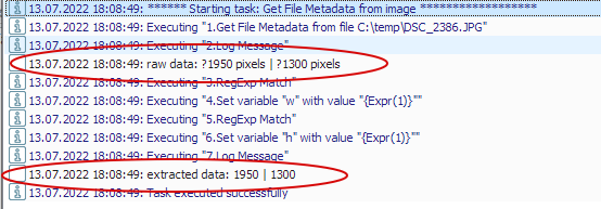

I writes small example (see below) and get the same result in service mode:
The log of the task
The log of the task
But you can extract numbers only by using regular expressions (see "Extracted data" line)

The process works fine with the 'RegExp Match'-action.
Thanks for your quick support!
