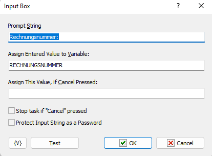

Hy,
sorry your example doesn`t work for me.
I would have a inputbox, with requires a input. No option to skip or empty entry.
Do you have a idea ? I can´t get it work..
Thanks

gremlin
Posts: 50
Re: InputBox not empty Loop
Post by gremlin »
Hy,
sorry for my bad description.
I would have a input box which doesn´t accept a empty value.
Thanks
Steven

gremlin
Posts: 50
Post by gremlin »
Hy, thank you for this sample.
When I press cancel , the Popup tell me "I press cancel". Thanks good.
But the Task end.
I need a loop. Where a empty or "cancel" option are not possible.
This is my Task:
