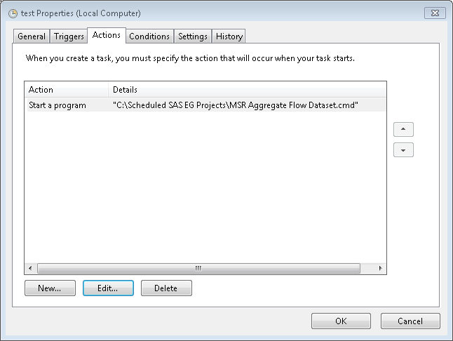

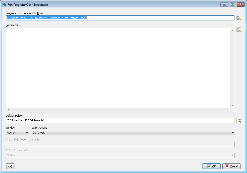

Hi, I am currently trying to run a .cmd file with a simply Run/Program task but it isn't working. The command windown just flashes and goes away. If I put a pause in the .cmd file, there is nothing there.... no errors or anything. The crazy thing is that I can call the same file with windows task scheduler and it works fine. Can you tell me why this isn't working?
I have attached screenshots of windows scheduler and robotask.
Windows Scheduler.png (12.53 KiB) Viewed 41222 times

I tried the similar task. It works
the task is
CatID=INTEGER|1680400764
ExternalName=STRING|"Task280"
ID=INTEGER|-258379537
Name=STRING|"Run ""Test cmd file with spaces.cmd ""..."
Name=STRING|"Run ""Test cmd file with spaces.cmd"" """
ifnonzero=STRING|"0"
program=STRING|"""D:\Just test folder with spaces\Test cmd file with spaces.cmd"""
runas=STRING|"0"
wait=STRING|"0"
workdir=STRING|"""D:\Just test folder with spaces"""
