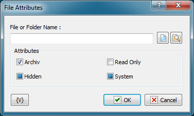

Sometimes you need to change file attributes in file operations. As a rule, the ReadOnly attribute inconveniences most of all.  This action serves for changing of file attributes.
FilesAttributes
File or Folder name
Specify the name of a file or a folder. You can use buttons on the right of an edit field. A file mask is inadmissible; that is, the action can process only the specified file.
You can use variables.
Attributes
Specify the attributes, which you want to set or to remove. This action can control 4 attributes:
Archive
Hidden
Read Only
System
Please, notice that Checkboxes have three positions:
Switched on – this means that you want to set an attribute
Switched off – this means that you want to remove an attribute
Grayed, or intermediate state – this means that you want to leave this attribute without changing.
By default, all the checkboxes are in Grayed state.
