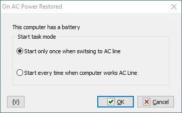

The trigger is activated when AC power of the computer is restored. Naturally, this trigger makes sense, if the computer has standby power supply from the recharging battery. For example: laptop or computer connected to the Smart UPS.
If you try to activate the trigger on a computer without a battery, the trigger will display the "This computer has no battery" warning in the RoboTask system log. In this case the trigger will not work.
OnACPowerRestored
Start Task Mode
Two trigger modes are possible:
Start only once when switching to AC line –  the trigger is activated once when switching to the mains supply.
Start every time when computer works AC line - the trigger is activated when switching to AC mains. Then the trigger is activated intermittently about once a minute when on the mains supply.
