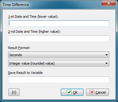

The action is intended tocalculate the difference between two values of time quickly. The result can be expressed in days, hours, minutes or seconds.
The value also can be obtained in the compound format: dd:hh:mm:ss
VariablesTimeDifference
1st Date and Time (lower value)
The lower value of time. Date and time must be specified in the current system date-time format.
2nd Date and Time (higher value)
The higher value of time. Date and time must be specified in the current system date-time format.
Note: If the first value is bigger, the result will be negative.
Result Format
You can select in which units to get the result:
Seconds
Minutes
Hours
Days
Compound format dd:hh:mm:ss
Additionally, you can specify the accuracy of the value:
Integer value (rounded)
Real value (floating point value)
Save result to Variable
Specify the name of the variable, in which the result must be saved.
