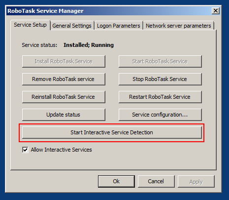

1-st way. By using "interactive service detection" service
- start RoboTask Service Manager and start "Interactive service detection"

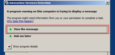

- You will see this message. Press "View the message"

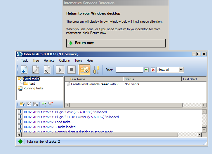

- You can see RoboTask window in the system session. Configure tasks interactively (or import prepared tasks) and press Return Now button on system dialog.

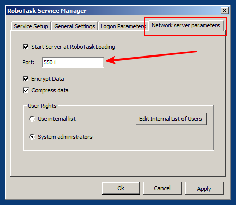

Run RoboTask Service manager, and setup network server for RoboTask Service. Pay attention that port MUST be different from network server settings of application
I recommend you to use the next number - 5501
press "Apply" button to save settings and restart RoboTask service.

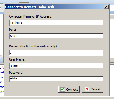

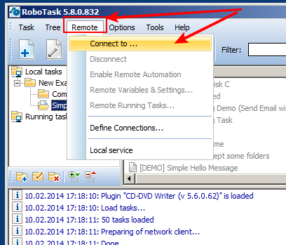

Choose menu Remote->Connect to...
Input necessary parameters and press "Connect"
You can see new Root folder in the task tree: localhost:5501
