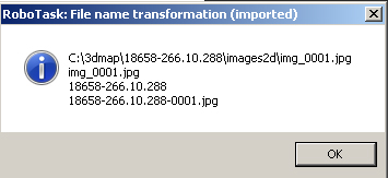

Re: rename file on base of foldername
in tis case try this expression:
{ExtractFileName({ExtractFilePath({ExtractFilePath({FileName})})})}
Variable FileName should contain the full path of the file.
See the example (step #5):
Hi,
I run the task, in the attachment the display message. But there is no filename changed...?
And is it possible to "read" the variable filename form the path? so the number "18658-266.10.288" because that is evertime different.
1-st line the source filename
2-nd file name only
3-d - the necessary folder name
4-th - new file name
Look at the task in the task editor.
You can set to vatiable FileName any new full path of the file and the task will parse it.
2-nd file name only
