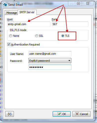

I need STARTTLS port for sending emails.I couldn't send email with TLS and I think there is a difference between TLS and STARTTLS and most of the SMTP providers are using STARTTLS nowadays.

Use these parameters for STARTTLS (see screenshot below)
It works on Gmail servers.

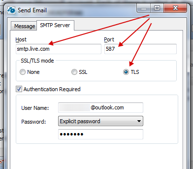

But it couldn't send email from outlook to hotmail.com
I am sure about config...I don't know what's wrong if there is no difference between starttls and tls.
Re: STARTLS port for sending emails
I tested Outlook SMTP with same parameters. I wrote the task and tested it. It works.
Probably you should tune settings in your account.
See here description of hotmail setting
