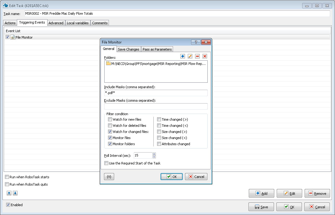

Hi Oleg,
I am trying to use a file monitor task to watch for changes to a .pdf file in a folder and send an email with that file if the modified date has been changed since the task last ran. I am running into problems. First, the task doesn't seem to be polling on its own. The only way I could get it to run is manually or adding a "cyclical" trigger before the File Monitor trigger. However, when I did that, It send the file even if the modified date hadn't been changed. Am I setting this up wrong? I have attached a screenshot.

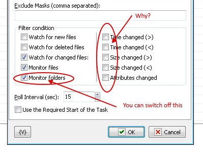

Look at the screenshot
Why do you turn off all criteria of changes? What do you want to monitor? You turned off all criteria, so file monitor can't detect any changes. File monitor doesn't analyze file content.
Usually you all criteria are switched on. When some program changes file then system change file date-time of last changes. In most cases file changes its size.
You can switch off "Monitor Folders" checkbox. It is for folders only (not for files)

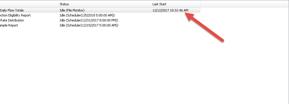

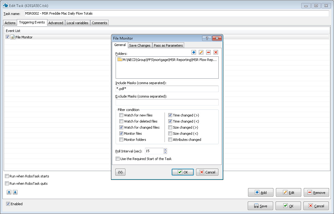

Post by elwayfan446 »
So I changed the settings to what you see below. I have it set to poll every 15 seconds. I know the file has changed since I enabled this. However, as you can see, it has not run since I manually ran it this morning.

What I can't figure out is why it doesn't even look like the task is running? The last start still shows the last time I manually kicked it off.
