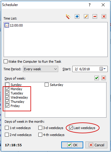

Re: Schedule for next to last business day of month
You can setup your task as my example below
CatID=INTEGER|1981091247
Events=FOLDER
ExternalName=STRING|"Task1"
ID=INTEGER|-617540483
Name=STRING|"Last business day every moth"
ActionID=STRING|"A_SCRIPT_VBEVALUATE"
Name=STRING|"VB Evaluate"
expression=STRING|"isLastBusinessDay(""{Date}"")"
line00000000=STRING|"function isLastBusinessDay(StrDate)"
line00000001=STRING|"  isLastBusinessDay = false"
line00000002=STRING|"  dt = cDate(strDate)"
line00000003=STRING|"  'month"
line00000004=STRING|"  m = DatePart(""m"", dt)"
line00000005=STRING|"  'weekday"
line00000006=STRING|"  wd = DatePart(""w"", dt, vbMonday)"
line00000007=STRING|"  'logmessage(cstr(m) + ""; "" + cstr(wd))"
line00000008=STRING|"  if wd >=6 then"
line00000009=STRING|"    'saturday or sunday"
line0000000A=STRING|"    exit function"
line0000000B=STRING|"  end if"
line0000000D=STRING|"  dt1 = DateAdd(""d"",3,dt)"
line0000000E=STRING|"  'month"
line0000000F=STRING|"  m1 = DatePart(""m"", dt1)"
line00000010=STRING|"  if m1 = m then"
line00000011=STRING|"    'not in last 3 days of the month"
line00000012=STRING|"    exit function"
line00000013=STRING|"  end if"
line00000015=STRING|"  dt1 = DateAdd(""d"",1,dt)"
line00000016=STRING|"  'month"
line00000017=STRING|"  m1 = DatePart(""m"", dt1)"
line00000018=STRING|"  'weekday"
line00000019=STRING|"  wd1 = DatePart(""w"", dt1, vbMonday)"
line0000001B=STRING|"  if m1 <> m then"
line0000001C=STRING|"    isLastBusinessDay = true"
line0000001D=STRING|"  else"
line0000001E=STRING|"    'next day sunday or saturday"
line0000001F=STRING|"    if wd1 >= 6 then"
line00000020=STRING|"      isLastBusinessDay = true"
line00000021=STRING|"    end if"
line00000022=STRING|"  end if"
line00000024=STRING|"end Function"
line00000026=STRING|"'logmessage(isLastBusinessDay(""3/30/2018""))"
linecount=STRING|"39"
loadfromfile=STRING|"1"
variable=STRING|"match"
connection=STRING|"0"
count=STRING|"1"
operator=STRING|"0"
type=STRING|"3"
value1=STRING|"{match}"
Name=STRING|"Show ""This is last business day"""
msg0=STRING|"This is last business day"
msg2=STRING|"Put your actions here."
msgcount=STRING|"3"
ActionID=STRING|"A_FLOW_ELSE"
Name=STRING|"Else"
Name=STRING|"//Nothing. This is NOT last business day"
comment=STRING|"Nothing. This is NOT last business day"
[Events]
Event1=FOLDER
[Events\Event1]
UniqueID=INTEGER|1587115508
[Events\Event1\Params]
periodicity=STRING|"1"
periodparameter=STRING|"0111110"
periodparameter2=STRING|"00001"
startdate=STRING|"43137"
time0=STRING|"43200000"
timecount=STRING|"1"
wakeup=STRING|"0"
The algorithm is simple:
Check the date: is this last business day or not
next use If..Then action
Also I set the scheduler trigger as on screenshot
Scheduler parameters

line00000002=STRING|"  var date = new Date();"
line00000003=STRING|"  var offset = 1;"
line00000004=STRING|"  var result = null;"
line00000006=STRING|"  if ('undefined' === typeof year || null === year)"
line00000007=STRING|"  {"
line00000008=STRING|"    year = date.getFullYear();"
line00000009=STRING|"  }"
line0000000B=STRING|"  if ('undefined' === typeof month || null === month)"
line0000000C=STRING|"  {"
line0000000D=STRING|"    month = date.getMonth();"
line0000000E=STRING|"  }"
line00000010=STRING|"  do"
line00000011=STRING|"  {"
line00000012=STRING|"    result = new Date(year, month, offset);"
line00000013=STRING|"    offset++;"
line00000014=STRING|"  } while (0 === result.getDay() || 6 === result.getDay());"
line00000015=STRING|"  //while Saturday or Sunday"
line00000017=STRING|"  return result.getVarDate();"
line00000018=STRING|"}"
line0000001A=STRING|"//LogMessage(FirstBusinessDayOfMonth(2018, 8))"
linecount=STRING|"27"
variable=STRING|"dt"
[Actions\Action29]
[Actions\Action29\Params]
count=STRING|"1"
operator=STRING|"0"
type=STRING|"0"
value1=STRING|"{DateTimeToFormat({Date},dd-mm-yyyy)}"
value2=STRING|"{DateTimeToFormat({dt},dd-mm-yyyy)}"
Name=STRING|"Create global variable ""DATECHECK_PERSMEETING"" with value ""No"""
varkind=STRING|"0"
varname=STRING|"DATECHECK_PERSMEETING"
varvalue=STRING|"No"
[Actions\Action30]
Name=STRING|"Create global variable ""DATECHECK_FIRSTWORKDAYOFMONTH"" with value ""Yes"""
[Actions\Action30\Params]
varkind=STRING|"0"
varname=STRING|"DATECHECK_FIRSTWORKDAYOFMONTH"
varvalue=STRING|"Yes"
[Actions\Action31]
[Actions\Action32]
Name=STRING|"//LAST WORKDAY OF THE YEAR"
[Actions\Action32\Params]
comment=STRING|"LAST WORKDAY OF THE YEAR"
[Actions\Action33]
ActionID=STRING|"A_SCRIPT_JSEVALUATE"
Name=STRING|"Check the last workday of current month"
[Actions\Action33\Params]
expression=STRING|"lastBusinessDayOfMonth({Year}, {MonthNo})"
line00000000=STRING|"function lastBusinessDayOfMonth(year, month) {"
line00000001=STRING|"var date = new Date();"
line00000002=STRING|"var offset = 0;"
line00000003=STRING|"var result = null;"
line00000005=STRING|"if ('undefined' === typeof year || null === year) {"
line00000006=STRING|"year = date.getFullYear();"
line00000007=STRING|"}"
line00000009=STRING|"if ('undefined' === typeof month || null === month) {"
line0000000A=STRING|"month = date.getMonth();"
line0000000B=STRING|"}"
line0000000D=STRING|"do {"
line0000000E=STRING|"result = new Date(year, month, offset);"
line00000010=STRING|"offset--;"
line00000011=STRING|"} while (0 === result.getDay() || 6 === result.getDay());"
line00000013=STRING|"return result.getVarDate();"
line00000014=STRING|"}"
line00000016=STRING|"//LogMessage(lastBusinessDayOfMonth(2018, 4))"
linecount=STRING|"23"
[Actions\Action34]
[Actions\Action34\Params]
case#1=STRING|"0"
count=STRING|"2"
operator=STRING|"0"
operator#1=STRING|"0"
type=STRING|"0"
type#1=STRING|"2"
value1#1=STRING|"{MonthNo}"
value2#1=STRING|"12"
[Actions\Action35]
Name=STRING|"Create global variable ""DATECHECK_LASTWORKDAYOFYEAR"" with value ""Yes"""
[Actions\Action35\Params]
varkind=STRING|"0"
varname=STRING|"DATECHECK_LASTWORKDAYOFYEAR"
[Actions\Action36]
[Actions\Action37]
Name=STRING|"FIRST WORKDAY OF THE YEAR"
[Actions\Action37\Params]
comment=STRING|"FIRST WORKDAY OF THE YEAR"
[Actions\Action38]
Name=STRING|"Define first workday of year"
[Actions\Action38\Params]
varkind=STRING|"1"
varname=STRING|"FIRSTWORKDAYOFYEARDATES"
varvalue=STRING|"02-01-2020{EOL}04-01-2021{EOL}03-01-2022{EOL}02-01-2023{EOL}02-01-2024{EOL}02-01-2025{EOL}02-01-2026{EOL}04-01-2027{EOL}03-01-2028{EOL}02-01-2029{EOL}02-01-2030{EOL}02-01-2031{EOL}02-01-2032{EOL}03-01-2033{EOL}02-01-2034{EOL}02-01-2035{EOL}02-01-2036{EOL}02-01-2037{EOL}04-01-2038{EOL}03-01-2039{EOL}02-01-2040"
[Actions\Action39]
[Actions\Action39\Params]
count=STRING|"1"
operator=STRING|"6"
type=STRING|"0"
value2=STRING|"{FIRSTWORKDAYOFYEARDATES}"
Name=STRING|"Create global variable ""DATECHECK_PRODSTOP"" with value ""No"""
varkind=STRING|"0"
varname=STRING|"DATECHECK_PRODSTOP"
[Actions\Action40]
Name=STRING|"Create global variable ""DATECHECK_FIRSTWORKDAYOFYEAR"" with value ""Yes"""
[Actions\Action40\Params]
varkind=STRING|"0"
varname=STRING|"DATECHECK_FIRSTWORKDAYOFYEAR"
[Actions\Action41]
[Actions\Action42]
ActionID=STRING|"A_DIALOG_QUESTION"
Name=STRING|"Question Dialog"
[Actions\Action42\Params]
abortif=STRING|"1"
action=STRING|"0"
autotime=STRING|"2"
buttons=STRING|"1"
message=STRING|"""So, {Date} has the following properties:"",,""Holiday: {DATECHECK_HOLIDAY}"",""Pers Meeting: {DATECHECK_PERSMEETING}"",""Productionstop: {DATECHECK_PRODSTOP}"",""Last workday of "",""month: {DATECHECK_LASTWORKDAYOFMONTH}"",,""Last workday of year: {DATECHECK_LASTWORKDAYOFYEAR}"",""First workday of month: "",{DATECHECK_FIRSTWORKDAYOFMONTH},""First workday of year: {DATECHECK_FIRSTWORKDAYOFYEAR}"",,""This message will close itself. See counter below."""
time=STRING|"10"
Name=STRING|"Create global variable ""DATECHECK_LASTWORKDAYOFMONTH"" with value ""No"""
varkind=STRING|"0"
varname=STRING|"DATECHECK_LASTWORKDAYOFMONTH"
Name=STRING|"Create global variable ""DATECHECK_LASTWORKDAYOFYEAR"" with value ""No"""
varkind=STRING|"0"
Name=STRING|"Create global variable ""DATECHECK_FIRSTWORKDAYOFYEAR"" with value ""No"""
varkind=STRING|"0"
Name=STRING|"Create global variable ""DATECHECK_FIRSTWORKDAYOFMONTH"" with value ""No"""
[Actions\Action8\Params]
varkind=STRING|"0"
[Actions\Action9\Params]
varkind=STRING|"0"
[Events]
Event1=FOLDER
[Events\Event1]
Name=STRING|"Scheduler(23-5-2019 00:01:00)"
UniqueID=INTEGER|1860671103
periodparameter=STRING|"1111111"
periodparameter2=STRING|"11111"
startdate=STRING|"42425"
time0=STRING|"60000"
wakeup=STRING|"0"
