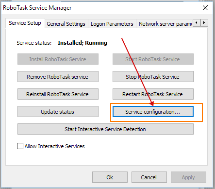

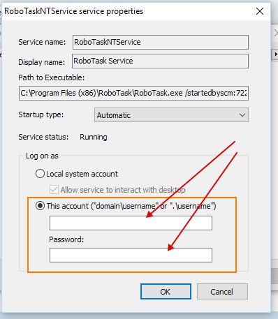

The system service works under SYSTEM account and has no access to network resources by default.
if you want to read or write files on network drive on other computer you have to specify authentication parameters for your RoboTask service
Read this chapter and related chapters about RoboTask Service mode.

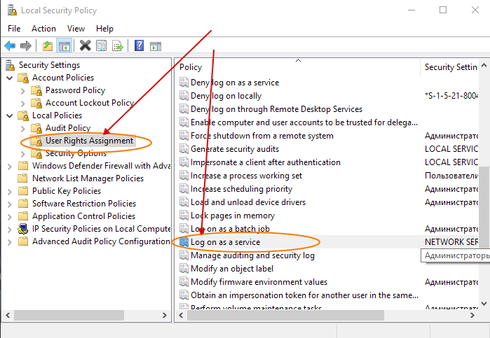

Also you can run RoboTask "as user"
But pay attention that this user must have "Log on as a service" permission
Look at the screenshot
