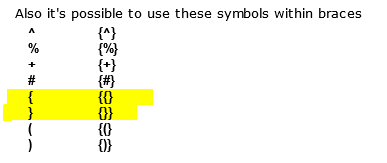

Also I checked the helpfile to use the "internal" code for the {
Capture 3.PNG (3.64 KiB) Viewed 14327 times
But also this doesn't solve this. However, I really need this command, else output is too large. How can I do this the best?

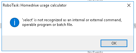

Re: Usage of accolade (braces) in Powershell
Almost there. It seems that the pipe sign | is messing up.
"Get-ADUser -Identity user -Properties ProxyAddresses | select -ExpandProperty ProxyAddresses | ? {$_ -clike "SMTP:*"}"

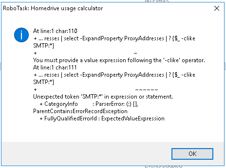

It seems you have to save your script into file with extension .PS1
and start it by command line
powershell -executionpolicy bypass -File <Filename>
Read more here, please
Also look at my example:
It works perfectly. Many thanks!
