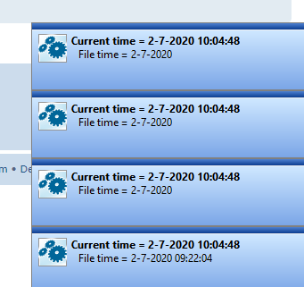

FileTime only returning date + time once
pancakegh
Posts: 15
Joined: Mon Feb 16, 2015 10:21 am
Post by pancakegh »
I have a folder where I export pdf's to. I need to filter for files that are newer than X seconds. The only filter I can apply with a file loop is the filter for newer than X minutes. I am trying to get the current seconds and the file seconds inside the loop but I can't seem to figure how to convert them to seconds.
Also, the first file is returning a correct date + time, but the files after that are not returning the time part, see attached.

How do I check if a file is newer than X seconds?

But I see on your screenshot that FileTime returns only date part for file time
Maybe disk P is some network drive and system returns only date part of full time.
Usually FileTime returns full time with date and time (hh:mm:ss)
