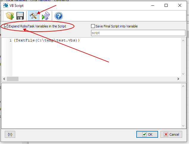

Re: "Old" Basic Script to new VB scripts in external file
Look at the screenshot how to include text from external file
Another way (more preferred):
use this text in VB Script text (for example)
execute include("C:\temp\test.vbs")
The extension is described here: https://robotask.com/help/index.html?sc ... esions.htm
These extensions works in actions:
