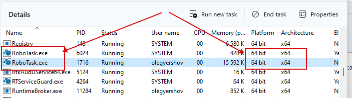

- Is Robotask V9.3 really a 64bit application?
Since version 8.0 RoboTask has two editions: 32-bit and 64-bit
You can see platform in system task manager (see column Platform and Architecture in details)
Task Manager.png (27.99 KiB) Viewed 5026 times
