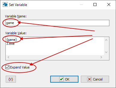

Re: I need help regarding adding a value to a variable.
How to assign/add values to a variable using it then? Not possible I guess?
This is possible. Look at the screenshot below and 1-st example (step #3). I don't think you saw it...
"Expand value" option means that the action calculates result before assigning. In this case you can use this variable in expression.

I think you misunderstood, I want a text box to appear (meaning I assign the value inside the texbox, not assigning it in the task steps) so I can input the value once i run the task, not when i set up the task.
