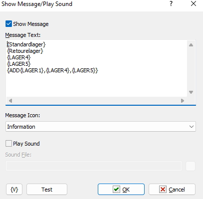

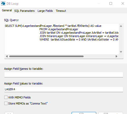

Hy,
I read some numbers from a sql database and store these into variables.
This works fine.
The numebers are enclosed by "". So the variable show "773737,33333"
I would like to do a addition of these variables , then reduce by 10%.
When I try to do a addition the result looks like this : "773737,33333""3232,323" "5454,35454"
I think the "" would make a addition impossible. I had tried to replace these with a VB Script and the Replace command, but the Chr(34) isn`t allowed.
Can you give me a hint how to do this ?
Thanks
Steven
Re: Addition of SQL Results
Function ADD accept as comma-separared string. So double-quote char is necessary.
Also I see that you miss round brackets ()
Function ADD can process only two values. So you can use such expression
{Add("{Add({Lager1},{Lager4})}",{lager5})}
Look at my example below:
CatID=INTEGER|327819672
ExternalName=STRING|"Task1430"
ID=INTEGER|550384746
Name=STRING|"add values"
Name=STRING|"Set variable ""lager1"" with value """"773737,33333"""""
varname=STRING|"lager1"
varvalue=STRING|"""773737,33333"""
Name=STRING|"Set variable ""lager4"" with value """"3232,323"""""
varname=STRING|"lager4"
varvalue=STRING|"""3232,323"""
Name=STRING|"Set variable ""lager5"" with value """"5454,35454"""""
varname=STRING|"lager5"
varvalue=STRING|"""5454,35454"""
Name=STRING|"Show ""{Add(""{Add({Lager1},{Lager4})}"",{lager5})}"""
msg0=STRING|"{Add(""{Add({Lager1},{Lager4})}"",{lager5})}"
