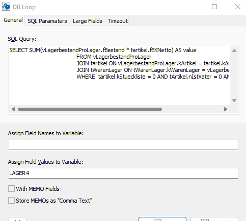

I read some numbers from a sql database and store these into variables.
This works fine.
The numebers are enclosed by "". So the variable show "773737,33333"
I would like to do a addition of these variables , then reduce by 10%.

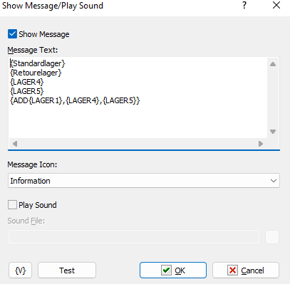

When I try to do a addition the result looks like this : "773737,33333""3232,323" "5454,35454"
I think the "" would make a addition impossible. I had tried to replace these with a VB Script and the Replace command, but the Chr(34) isn`t allowed.

Function ADD accept as comma-separared string. So double-quote char is necessary.
Also I see that you miss round brackets ()
Function ADD can process only two values. So you can use such expression
{Add("{Add({Lager1},{Lager4})}",{lager5})}
