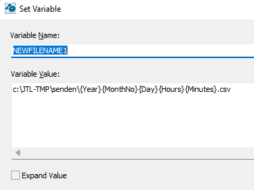

Hy,

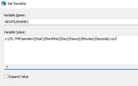

if i generate a filename then it will be updated on the fly:
I helped myself by leaving out the seconds, but if the minute changes during execution, the variable changes and the file is no longer found at the end of the task.
I actually wanted to add a random function so that the file name is always different. but here the content is newly generated for each variable. Is it possible to somehow create the variable at the beginning of the task and then it remains the same throughout the procedure?
Thanks
steven
Re: Variable to generate Filename
Turn this option ON
In this case RoboTask calculates the value before assigning it to variable
Otherwise, if it is unchecked then RoboTask calculates the value every time you use variable NewFileName1. And you can get another value every time.
