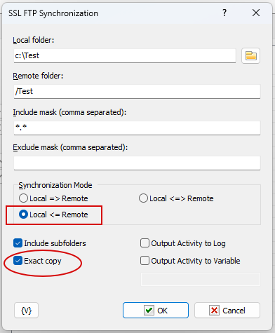

Use SSL FTP Synchrinization action with these parameters (see screenshot)
SSL FTP Exact Synchronization.png (21.3 KiB) Viewed 17895 times

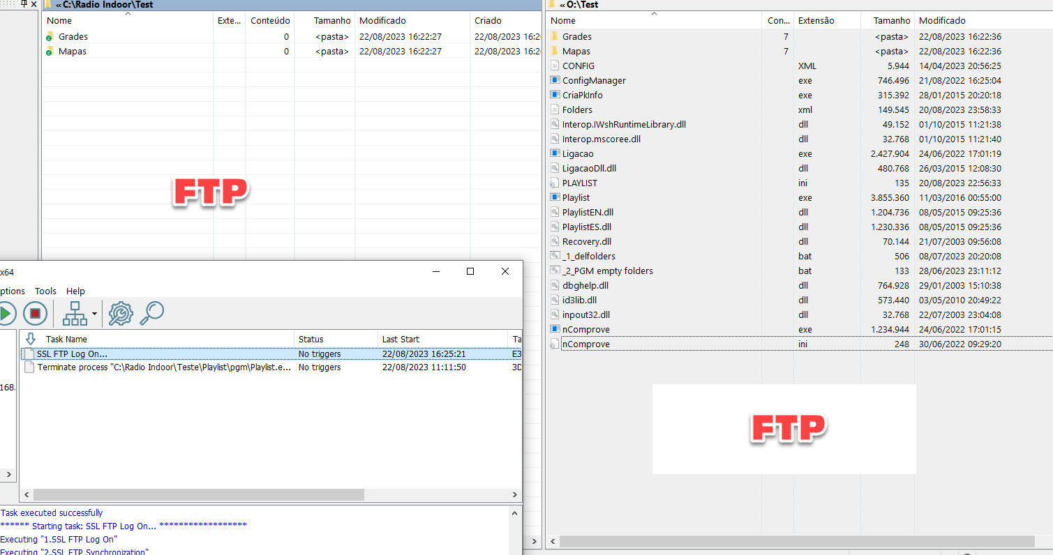

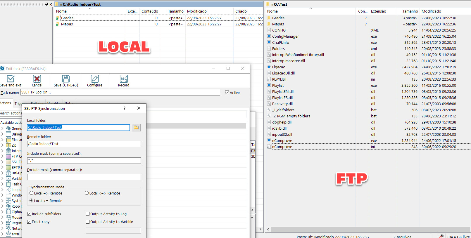

Unfortunately it doesn't work for me, some files are deleted in the FTP folder, and files and folders created in the local folder are not deleted... I don't know why this happens, since I follow the parameters I would not like the synchronization to be automatic, I would like the every 30 minutes sync.
the O:\ is just a path to my FTP\Radio Indoor\
