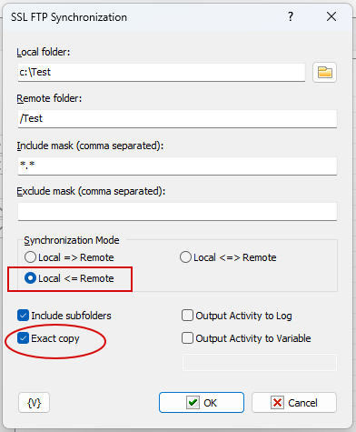

Hello Oleg. Could you please create a task to synchronize the FTP, because I've tried several ways and I can't. How will it be:
My local folder will be called c:\Test and my FTP folder will also be called /Test
How do I make all folders and files in my local folder identical to the folder that is on the FTP? Even if any folder or new file is created in the local folder, when executing the task, the created files will be deleted, as they will have to be identical to the FTP, I don't know if I could be clear. Thanks.
Re: Task to synchronize the FTP...
Posted: Tue Aug 22, 2023 3:23 pm
Use SSL FTP Synchrinization action with these parameters (see screenshot)
SSL FTP Exact Synchronization.png (21.3 KiB) Viewed 17902 times

Unfortunately it doesn't work for me, some files are deleted in the FTP folder, and files and folders created in the local folder are not deleted... I don't know why this happens, since I follow the parameters I would not like the synchronization to be automatic, I would like the every 30 minutes sync.
the O:\ is just a path to my FTP\Radio Indoor\

maybe something wrong in your task
I tested this on our FTP test server and try my task. See the log. It works, I changed files on FTP and local forlder. Next I run the task, it make folders identical
Attach to this task Cyclic trigger. Use the inteval 1800 sec (30 minutes)
