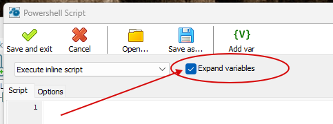

Re: Change File Date or Time
Maybe you forgot to switch on this option?
If you are using RoboTask variables in script body you should expand variables before running.

ID=INTEGER|-1716440280
Name=STRING|"change createion time of the file"
StepPause=INTEGER|0
Name=STRING|"Set variable ""filename"" with value ""D:\systemp\test.txt"""
_rt_variables_produced=STRING|"filename"
varname=STRING|"filename"
varvalue=STRING|"D:\systemp\test.txt"
Name=STRING|"Set variable ""creationDT"" with value ""2024-07-16 10:00:00"""
_rt_variables_produced=STRING|"creationDT"
varname=STRING|"creationDT"
varvalue=STRING|"2024-07-16 10:00:00"
Name=STRING|"Set variable ""writeDT"" with value ""2024-07-16 11:00:00"""
_rt_variables_produced=STRING|"writeDT"
varname=STRING|"writeDT"
varvalue=STRING|"2024-07-16 11:00:00"
ActionID=STRING|"A_SCRIPT_POWERSHELLSCRIPT"
Name=STRING|"PowerShell Script"
command_line_template=STRING|"""[InterpreterPath]"" -ExecutionPolicy RemoteSigned -File ""[ScriptPath]"""
script_0=STRING|"(Get-Item  ""{filename}"").CreationTime = '{creationDT}'"
script_1=STRING|"(Get-Item  ""{filename}"").LastWriteTime = '{writeDT}'"
script_count=STRING|"2"
script_type=STRING|"0"
search_paths_count=STRING|"0"
use_embedded=STRING|"0"
Post by OldGeek »
That worked, thank you very much
