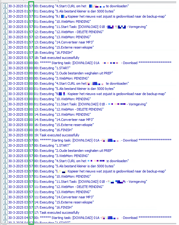

Last sundaynight, 30th March at 2:00 AM (02:00) the daylight saving time in Europe started. This means the time skips to 3:00 AM.
We have a task which runs every hour at xx:57:00.
In the logs, I've discovered that suddenly the task was started at 3:00, I assume because officially the task at 02:57:00 was skipped ofcourse. That time never existed. Robotask was shocked about this ;) , and executed it. Am I right? Is this by design? Is this a setting?
Yes, you are right
Scheduler trigger uses local time of computer. Thus, this effect occurs during the transition to summer/winter time.
Also, this effect occurs when you wake up the computer and the control time has passed while the computer was asleep.

Allright, good to know. Thanks!
