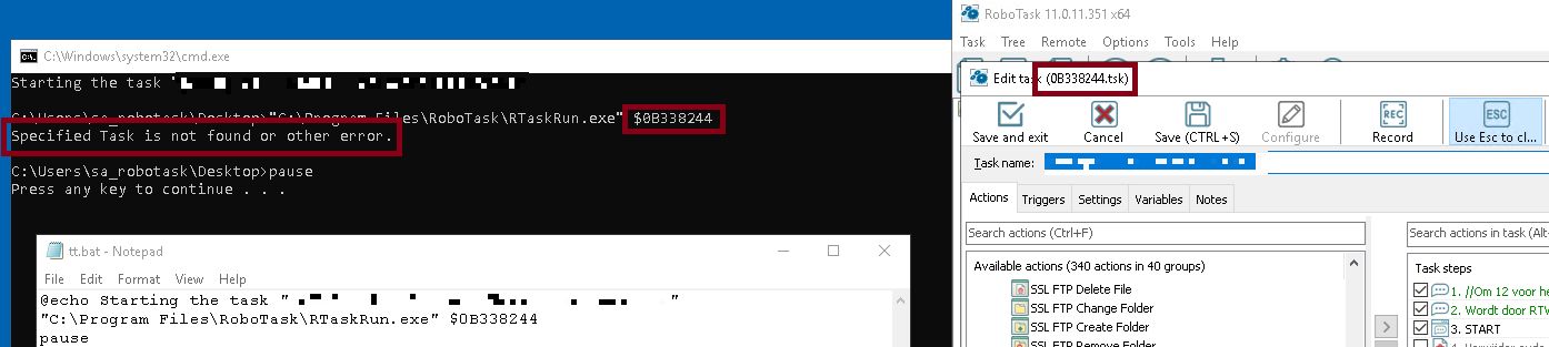

On a task, I created a batch file on the desktop. When I execute it, he doesn't like it. What do I miss here? I created it by right clicking "Create batch file" and added the pause command to see why I didn't ran.
When I run the task itself in Robotask, it works great.

This is possible when the task is busy. For example the task is opened in task editor or running.
In this case you will get exactly this error.
Close task editor and try again.
Re: Created batch file seems....incorrect
I did, but no difference. The task wasn't busy and the editor wasn't opened. When I run the task in Robotask manually it responds as it should.
I've tried it with 2 other tasks: same behaviour.
Maybe RoboTask is running in "As administrator" mode?
In this case you will get the same error. You must run you CMD/BAT file with administrative permissions too.
You cannot send commands to an application with higher privileges.
Correct, that was the trick! Run as admin: batchfile works.
