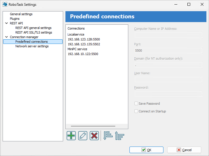

Predefined connections
To connect to the necessary server of the RoboTask quickly, you can specify the connect parameters in advance.
ConnectionMan1
Each predefined connection contains such parameters:
Computer name or IP address
Port
Domain (for NT authorization only) - you can specify single dot (.) if you are using non-domain user (local computer user)
User name
Password
Save Password - switch on this checkbox if you want to save password
Connect at startup - switch on this checkbox if you want to activate this connection when RoboTask starts.
