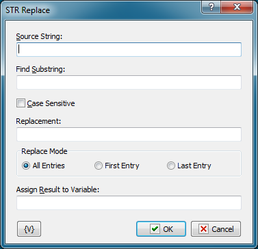

This action finds and replaces the specified string with the one you need. There are three replacement modes:
All Entries;
First entry;
Last Entry.
The result is assigned to a user variable.
STRReplace
Source String
The source string to search and replace in. It is possible to use variables.
Find Substring
The substring that should be found and replaced. It is possible to use variables.
Replacement
The substring to replace the found substring with. It is possible to use variables.
Replace mode
Replacement mode. 3 options are possible:
All Entries – all found substrings will be replaced;
First Entry – only the first found substring will be replaced;
Last Entry – only the last found substring will be replaced;
Assign Result to Variable
The name of the variable the result of the action will be assigned to. It is impossible to use macros with variables
